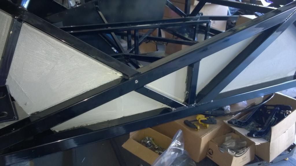

    After delays, delays and more delays took delivery of the kit last Friday; chassis #206.
    The driver Steve was super helpful and made the act of suspending a car in the air held up by a few chains not a total disaster.
    Over the weekend I got through stripping the chassis and inventorying a few boxes. Should get through the remaining ones this week; then we can get to work.
    (yea, about the floor -that's a long story involving a nest of angry hornets... not a happy memory)
    FYI, gas tanks are still back ordered (well mine is anyway…), and a couple of other parts. Gives me a chance to catch up on the clean/ remanufacturing of parts that I’ve been slacking on.

    How many quarts you think you may need for front FW, side panels, front hood, front fenders, rear deck lid, rear trunk lid, rear bumper and rear fenders, all that with 3 coats?
    I think 5 quarts won't be enough.

    Frank, I have about 1/2 of the quart left after doing the front and sides with 2 coats. I have no idea how much would be needed to cover the inside fiberglass, hadn't considered doing that since I don't think the Liquid-Damp is very weatherproof.
